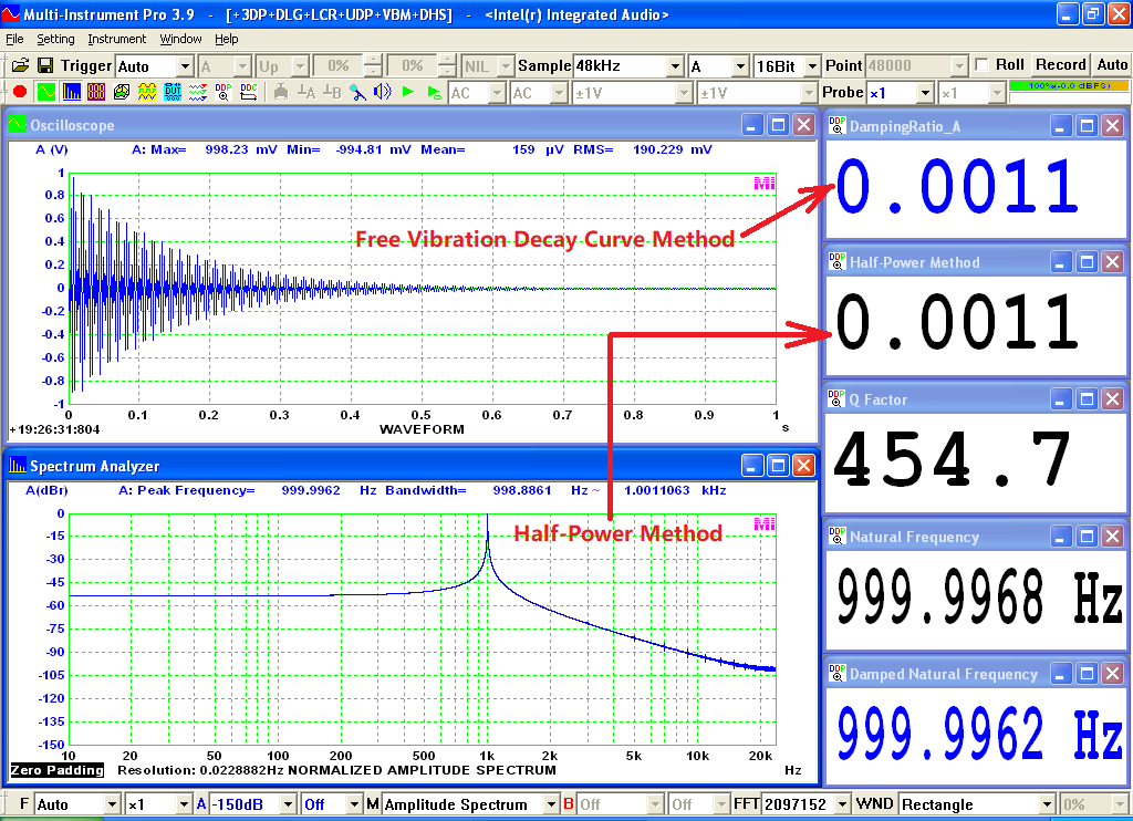

The free vibration decay curve method requires MI full package. To enable damping ratio measurement using this method, right click anywhere within the oscilloscope window and select [Oscilloscope Processing]>"Damping Ratio", the corresponding DDPs are DampingRatio_A and DampingRatio_B.
In the half-power method, the damping ratio can be derived using ([BandWidthHighLimit_A(Hz)]-[BandWidthLowLimit_A(Hz)])/2/[f1Freq_A(Hz)] for Channel A. This formula can be used to define a UDDP.
