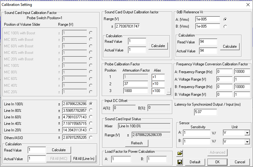

I spent 2 hours calibrating the sound card as MME. The Zsc has been calculated fine at 4.54KΩ. The output amplitude of the signal generator is also calibrated and its max level is 2.8Vp. Later, I tried some measurements of components. Measurement of linear loads like resistors is very accurate but doesn't apply to complex loads like capacitors and inductors. I tried with all readily offered psf and with different capacitors and inductors but had no luck. E.g. a 470nF cap is calculated as 13uF while on the green window the allowable range shown, is from 240pF to 2uF. I understand that the signal level should be set within the percentage shown on the green window, to obtain a corresponding component measurement. The problem arises from the fact that the level of the signal generator is locked at 1Vp and that level is insufficient for the measurement. Or the minimum resistance of 1KΩ of the probes is so big.
My settings for LCR measurement are 1) Sound Card MME for both ADC and DAC to have control of volume 2) The switches on both P601 probes at position 1, so "2 [P1+P1]. 3) On the Sound Card control panel Playback and Record sliders are all at 100%. The master volume can be set at 66% as much. With these settings, the maximum level obtained is 47.23%. If the master volume is placed above 66%, the indication on the green window is turned BAD because the signal is clipped.
I think the calibration that I did, using the MI signal generator and an external true RMS voltmeter is correct. Please take a look at the picture and tell me what you think.

1. Actually only relative values are needed in LCR measurement here. Calibration is not necessary but there is no harm to do that.
2. The inaccuracy in your measurement of 470 nF seems to be too big. If you want to check the cause of inaccuracy, the input impedance of the sound card at 1kHz (4.54k?), input peak levels (47.23%?) without and with (?%) the 470 nF connected need to be known here. With these values, the capacitance under test can be derived through formula. Moreover, as indicated in Section 9.8, the accuracy will be the best in the middle of the measurement range. The impedance of 470 nF is 0.3386k at 1kHz and 3.386k at 100Hz. The value 3.386k is comparable to the sound card input impedance 4.54k and thus the measurement will have a higher accuracy at 100Hz than 1000Hz. You can load LCR_100Hz.dtp to see if a better result can be obtained.
