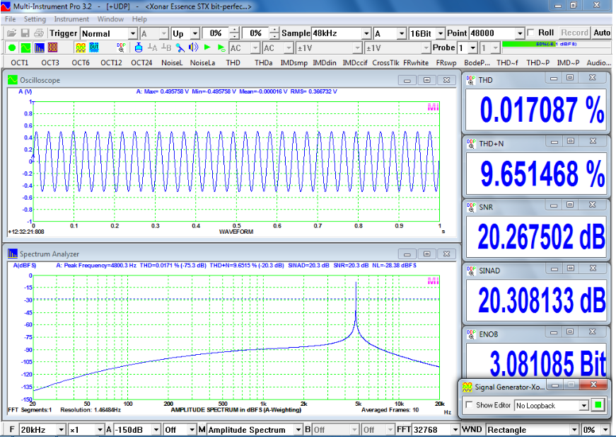

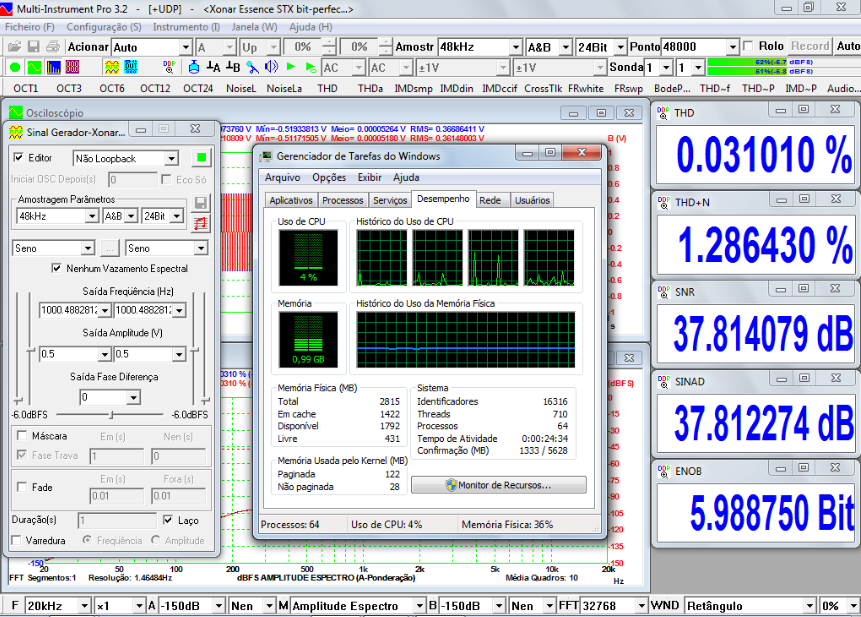

Post at 8-10-2012 07:23
Problems using MI
Problems using MI
- MITHDA1.png (225.1 KiB) Viewed 261437 times
- MITHDA2.png (251.73 KiB) Viewed 261440 times

Can you show me the figure above with better resolution in order to see the configurations you´re using toi achieve those results? I´ll try to reproduce it here.
And, can you tell me what is the PC configuration you´re using too?

Actually I did this using a multiple frequency in order to see the correct beginning and end of the waveform on scope.
Using rectangle window I have the first picture below.
If I understand well your instructions, there are no discontinuities (if not, actually does not matter the window type, it would happen using Kaiser 6 too) and the scope shows 33 complete cycles of a 480.3Hz sinus (actually 480Hz in the generator panel). The problem is still there.
In the second I have the same frequency but using Kaiser 6 and 480Hz. the results are consistent with the 16bits depth and are ok.

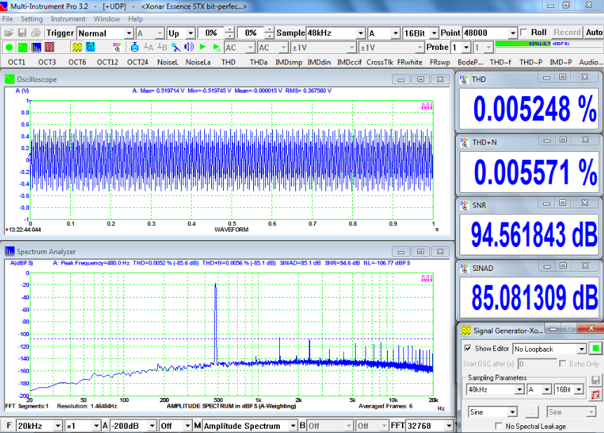

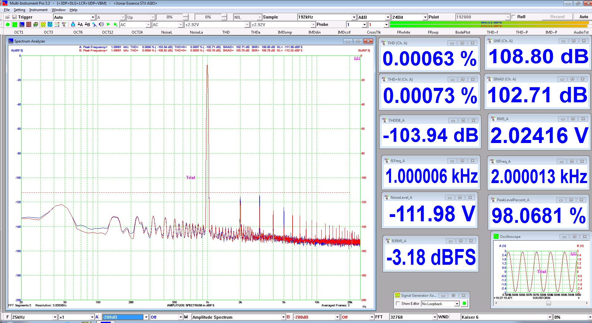

- XonarMIKayser.png (236.31 KiB) Viewed 261437 times
- XonarMI.png (234.62 KiB) Viewed 261437 times

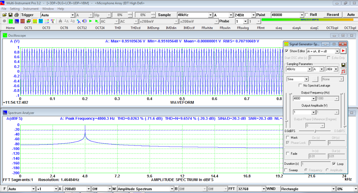

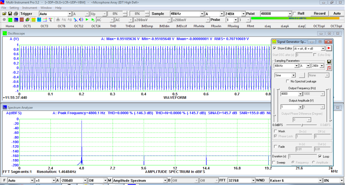

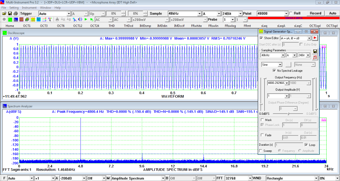

Re: Problems using MI
Thank you for the info. Now, it is clearer. This is not a software bug. The software works perfectly indeed.
In your Fig. 1, the signal frequency measured in the spectrum analyzer is 4800.3Hz (according to you, the signal frequency in the signal generator panel is 4800Hz), but in the oscilloscope window, "33 complete cycles" of the signal is displayed in a 1- second long frame. Obviously, this is an "Alias" effect in display. If the signal frequency is 4800Hz, then there should be 4800 cycles displayed in 1-second long frame. If the signal frequency is 480Hz, then there should be 480 cycles displayed in the 1-second long frame. If you only count from POINT 1 to POINT 32768 (i.e. a 32768-point FFT segement), then there should be 32768/48000* 4800= 3276.8 cycles for the case of 4800Hz and 32768/48000* 480= 327.68 cycles for the case of 480Hz. If you (1) zoom sufficiently or (2) right click anywhere within the oscilloscope window, select "oscilloscope chart option" and choose "display all data points" , the "alias" effect will disappear.
Note that in both cases (4800Hz or 480Hz), the FFT segement (32768 points) contains a non-integer number of cycles, which requires you to use Kaiser 6 to suppress the spectral leakage when you want to measure the harmonic distortion. Again, in MI, for THD measurement, it is suggested that a rectangle window function can be used only when an integer number of cycles are contained in a FFT segment (not the oscilloscope frame), otherwise Kaiser 6 must be used instead. Hope the following three figures can help to make the above idea clearer. The three figures were obtained by digital loopback at software level (ideal case), which means THD should be very much close to zero if the measurement parameters are set properly.
(1) Fig. 1, signal frequency =4800.29296875Hz, the FFT segement (32768 points) contains 32768/48000*4800.29296875 =3277 cycles, rectangle window function can be used.
(2) Fig. 2, signal frequency =4800Hz, the FFT segement (32768 points) contains 32768/48000*4800 =3276.8 cycles, rectangle window function is used with THD measurement accuracy affected quite significantly.
(3) Fig. 3, signal frequency =4800Hz, the FFT segement (32768 points) contains 32768/48000*4800 =3276.8 cycles, Kaiser 6 window function is used to suppress the spectral leakage in order to measurement THD accurately.
As fas as we know, RMAA uses a non-rectangle window function to suppress the spectral leakage regardless of whether an integer number of cycles are contained in the FFT segment or not. Therefore it is always on the safe side. But it may introduce a little distortion when an integer number of cycles are actually contained in the FFT segement. On the other hand, MI gives the user much more options and flexibility in handling different situations.
virtins
Post at 15-11-2012 13:13

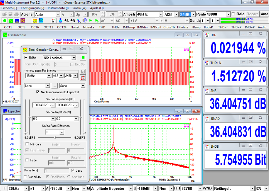

Ok, tks again,
Actually the frequency I used was 480Hz, but it is not a problem here.
In the real life the measurements without the sound card only shows that the software is OK, except in the IO to DAC and from ADC.
I tested the system using the default parameters (rectangle and non integer freqs) and for 16bits and one channel I achieved satisfactories results. So, I tried 24bits and two channel configurations. After many tweaks I achieved satisfactories results with a minor misbehaviour with Xonar.
I had to:
- uninstall all features that controls the clock and bus of the Mobo in order to have energy saving (Asus softwares, in my case);
- put the windows in the performance mode at energy mode configurations at control panel);
- change the latency of the Xonar to the maximum (80ms);
- change the latency of the Juli@ to the maximum (2048 samples);
- put the trigger in AUTO mode and restart the spectrum analyser after started the signal generator.
As you know Xonar Essence and Juli@ are top class sound cards, and seems to me Virtins could spend a little more time in order to increase the performance using internal sound cards, maybe working on the synchronism or buffering.
At the end I´m trying to modify the parameters of your DTP archives to use 24bits and change the windowing and signal levels, but with no success until now. Could you elaborate a bit more your explanations above for me?
Tks in advance and best regards,
MarceloYared

After a last exhaustive research, i could confirm you that the ASUS drivers - i.e. the C-media Oxygen ASIO driver - for Win7 are wrong. There are 4 different driver upgrades offered by ASUS and i've tried one by one without any improvement in FFT tests. The function "No spectral leakage" can't be used. When is enabled, in oscilloscope window i can see a constantly repeated bounce per second, it seems like oscilloscope is re-triggered continuously, is unstable and similarly the FFT analyzer. There is problem of synchronization. The only solution is the use of smoothing window i.e. "Kaiser 6".
Another one issue is the bad frequency response. In Bandwidth Test the upper -3dB frequency limit lies at 50 to 60KHz!
All above tests are executed in "No Loopback" mode at 192Ks / 24bit with ASIO = auto.
I am completely disapointed, in my previous PC with "WinXP x64" OS everything were OK! Now, with "Win7 64bit Pro" OS the ASUS XONAR Essence STX is useless, its performance in "No Loopback" tests is unacceptable. I can't use MI Pro 3.3 anymore. The only solution is to spend another 150 to 200 Euro to buy a new sound card and to throw the ASUS XONAR in the trash bin.
I am so sorry.
Fotis

just got a screenshot from the Editor-in-Chief, http://www.canardpc.com/, he used ASUS XONAR Essence STX.
virtins

Post at 10-1-2013 20:01
ASUS drivers for Win7 are rubbish
Hi to all
I am so sorry.
Fotis
Post at 13-7-2013 14:35
"No Spectral Leakage" option requires more communication bandwidth between the software and the sound card as the signal frequency is normally not an integer, maybe the ASUS's new driver does something wrong when handling higher communication traffic. Anyway, Kaiser 6 option should be good enough for THD measurements.
virtins
Post at 15-7-2013 19:36
virtins
Post at 3-10-2013 12:44
- MI-THD-using-Asus-Xonar-Essense-STX-ASIO-by-Canardpc.png (67.38 KiB) Viewed 261435 times
khushfehmi045
- Posts: 1
- Joined: Sun Dec 07, 2014 9:44 am
I had to:
As you know Xonar Essence and Juli@ are top class sound cards, and seems to me Virtins could spend a little more time in order to increase the performance using internal sound cards, maybe working on the synchronism or buffering.??
