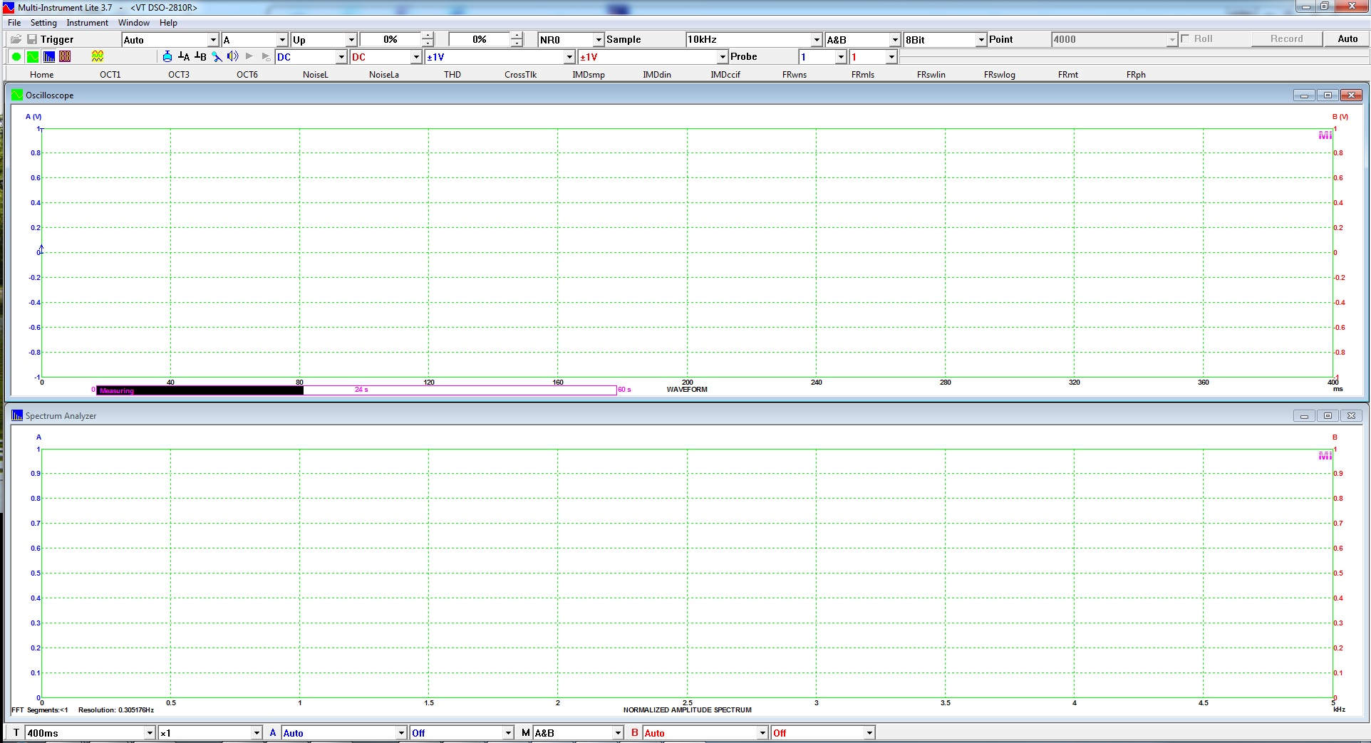

I have tried to use it for a day or so. I supply a repeating signal from a sound card. When I launch the application, everything works fine. However, if I try to change the sample frequency or capture window size, roughly 50% of the time, the signal disappears and the software waits to trigger. The trigger settings are default (ie auto, 0% change...), so any minute signal noise should trigger. I have attached a screen grab of this happening. The green light on the DSO-2810R remains lit. To get the system working again, I have to close the application and pull the USB cable out and put it back in. I am using windows 7 pro on a HP laptop.

I have tried a different cable, port and computer and it still performs in the same erroneous way. Looks like a hardware fault.
