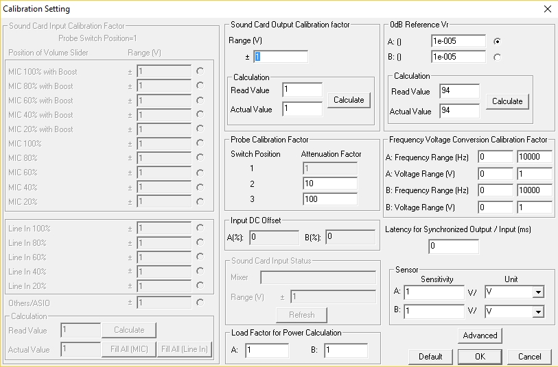

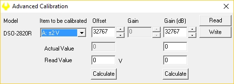

Re: Calibration problems
I ran the test you ask for. I checked the 10X probe setting and they were in the 1X position for both probes.
When I change from 2Volts to 5Volts I don't hear the relay chatter on either channel.
Thanks for your assistance!
I suppose it needs a new relay or 2?

The chances for two relays to fail at the same time is very low, unless somehow the power from the USB port is not enough. You can try it on another computer or use another USB cable. A relay click sound should also be heard when switching from a sampling rate of 200MHz to a sampling rate of below 200MHz.
Also, under Gain(dB) column of the screenshots, "32767" is displayed for both cases. This is also a little strange as the number does not seems to be the ones set by the factory. Did you try to re-calibrate it by yourself?
